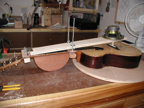

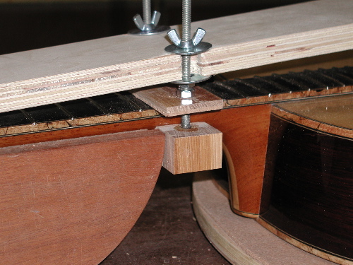

Something like this?
PostPosted: Mon Mar 06, 2006 6:42 am
Posts: 1075
First name: Coe
Last Name: Franklin
City: Decatur
Paul, I like the setup you have there. Would there be any benefit to having it strung up to get used to the tension during break in?
PostPosted: Mon Mar 06, 2006 7:04 am
Might be. I'm not sure. But the way I have it clamped to the neck won't allow for strings without grinding them into the fingerboard.

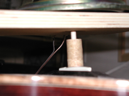

What Paul rigged is a sort of 'stinger'. I usually cut out most of the speaker cone, and use a cork or balsa 'stinger' glued to the coil cover. You can hang the guitar up, with strings on it, and have the stinger on some sort of a stand. As long as there's enough pressure of the cork on the bridge saddle to keep it from buzzing (you'll know!) it will work fine. Alternatively, you can rig some sort of a clip to clamp to the saddle. You are, of course, converting the guitar into a very lo-fi speaker with this.
This is a _whole_ lot more effecive than setting the guitar in front of speakers. With 'air to air' coupling most of the sound just bounces off, and the guitar really doesn't move much. You need to blast it to get anywhere: remember 'TimbreTech'? With a stinger you can put a lot more energy where you want it without having to crank things up too loud. a couple of watts of input power will make a noticable difference over a weekend.

Gee, Hesh, I thought I was pretty clear. As I say, you remove most of the cone of the speaker, so it won't make too much noise by itself, but leave enough to hold the coil in place. Carve a cork into a cone long enough to protrude past the speaker frame, and about the same diameter as the coil at the bottom and 1/8" or so on the top. Glue it to the coil. Set the speaker up on some sort of stand, such as a tripod, and hook it up to something that can put out a couple of watts of power and play some music.
Hang the guitar up by looping a string under the E string tuners. Damp the strings with some strips of foam slipped in underneath: I usually put them at the 4th and 11th frets. Move the speaker stand in until the point of the 'stinger' cork touches the bridge saddle. perpendicular to the top. Turn on the music. If it buzzes move the speaker in so that it makes firmer contact.
A refinement is to use some sort of clip on the stinger. I got some tiny clip clothspins once at a 'craft' store that work OK; they're about an inch long. The little triangular metal pinch-type paper clips work well, too. This will allow you to put more power in.
